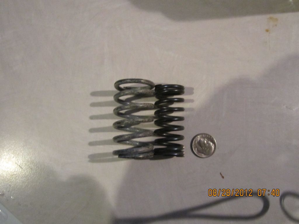

OK, I'm going to get that spring back in the 1-2 accum soon... starting to do a bit of damage to my old worn out irs system and I'm tired of throttling out during DD so i don't get the neck jerk/tire squawk >.> eventually i plan to rebuild everything back their and get myself a traclok, but still... i just find that hard 1-2 a little annoying for the daily drive...
pretty sure i found them in the toolbox, but i don't think the smaller spring is right... anyone want to chime in and tell me what i have are the right springs before i drop the pan and find out myself?
5,862 Posts
The little spring looks like the 2-3 accumulator spring.
The bigger one just looks ... funky. Like maybe it was the bottom spring on the 1-2.
ANY spring you put on the top of the 1-2 will soften that 1-2 shift. I put mine in when I did my j-mod on the Bird because it's Daniela's DD; she's very happy with the performance. Trust me, she does NOT like neck-snapping shifts!

see that's what i thought too... but i could only find those two.. :zdunno:
suppose I'll have to check the toolbox again tomorrow, see if i cant find another one. either that or I'm sure the local dealership will have 1-2 acuum springs for a 4R70w in stock... theirs millions of them out their and they break a lot.
also my camera clock must be off >.> how did i take that picture in the future and post it 40 min in the past...
5,862 Posts
You can use that spring - it will work. Like I said ANY spring will make a difference.

i would just wonder if it would stay in place. i don't want it rattling around in their. i know the ones i took out were tight as heck, the dang accum popped out with quite a bit of force when i removed the C clip.
hmmm after a bit of looking around i was able to find a picture from someone elses pulled accum...
now i know i dont have the right ones. i remember mine looked pretty much just like that >.>
pretty sure that at least the larger one i have is the blue one with its paint worn off... maybe i should just buy new ones >.> if its been used long enough for the paint to be gone like this its prolly worn out and ready to break anyway...

Mine looked like that too. The longest one went on top (goes in first), then the accumulator, then the shorter spring. I put a blue spring on top of mine and the same purple one on the bottom that came out originally.
Ford has several springs for different applications - let me see if I can find my info sheet.....
Ok, from stiffest spring (harsher) to weakest (softest shift):
Brown - used in trucks
Light Green - 01-05 4R70W
Light Blue - 98-2000 4R70W
White - 1995-97 4R70W
Dark Blue - 1994 4R70W
I don't know how stiff that red one is in the pic! lol

hmmm, well i cant seem to find my old one anywhere, so i guess ill just have to visit the dealership.
that chart is helpful actually, i suppose i would want the light green. i don't want a soft squishy old man shift, but i still don't want the necksnapping "yikes it sounds like i broke something" no-spring shift either...

hmmm, after reading back into the jmod articles and doing a bit of searching online i think i might have this all backwards... i need the lower accum spring back in. which would probably explain why i cant find the blue upper spring, i think i left it in the bore when i put everything back together as i was told on the articles...
am i right? :facepalm:
5,862 Posts
If you're trying to soften the shift, you need to put them BOTH back in.
The spring you put in the hole FIRST before you put the accumulator in will make the shift HARDER the stiffer it is.
The spring you put in AFTER the accumulator will SOFTEN the shift the stiffer it is. If you eliminate this spring, the shift will be HARDER than if you put it back in.
The faster the accumulator goes down the bore (like coming OUT of the hole), the harder the shift. Does all that make it any clearer?

very clear, it seems i need the lower spring then.

got it back in. so much better now. oddly enough it still shifts quite well, you can definitely still feel it kicking into 2, but its not bone shaking, wheel chirping bad after 1/4 throttle anymore :)
a floor jack, half inch extension and a large socket worked quite well to push the accumulator back up into the bore and get that snap ring back in.
