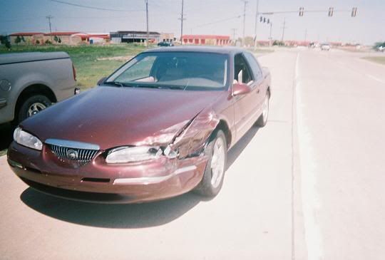

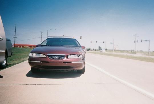

These are the only pics I have of the grill when I had it on my car, just ignore the body damage. It wasn't my fault. Anyways I thought I'd post it thinking maybe somebody else would like the look. I don't have the the factory grill anymore since I have the grill mesh recessed (pics in link in sig) All you do is unbolt the grill, remove all the brackets, and cut the top of the grill off at the sharp bend (corner) were it bends back to mount to the hood, test fit it. the grill is wedge inbetween the header panel and the bumper reinforment bar. trim till you get a snug fit. and put two screws through the header panel and behind the grill to keep it from moving. I thought it gave it a nice look by blunting up the nose.
