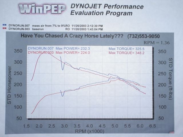

New found power with the 97 Cougar. After a really long wait from Fchip my EEC came in and the car was ready for the dyno. I am glad I did because she was really lean.
Went over to Second Street Speed for a Dyno tune to make her drivable. I tell you one thing Lon at Second Street Speed knows EEC's! It was remarkable how he knew exactly what to tell me to change on the EEC tuner and how the Cat obeyed him. For example he said lets put these numbers in the WOT trim to get an AF ratio of 12. Bam, he hit the numbers on the first try.
Now I have 225 HP at 311.7 Ft-lbs! Here is the dyno:
Thanks Lon!
It is true that I have some adjusting to do but the hard stuff is behind me.

John,what are you considering lean?
12:1 is a rich a/f for a N/A motor...especially a modular.

JL,
With the EEC she was running at 18:1. If I did not resist the temptation to cut her loose I could have lost her.
It is true that 12:1 is rich for a 4.6L but a 5.4L is a stroked 4.6L and she gets the most HP running at 12:1 on WOT with the TQ locked up. Over the years I must have been on the dyno 20 times. I started at 13.5:1 and worked my way down until the HP started dropping off. The best WOT for my motor was 12:1.
Please note that when the TQ is unlocked she runs a little leaner. If I remember correctly at idle she was at 14-15:1 (I do not remember the exact numbers but I let Lon pick them) and averaged around 13 at part throttle. But when I stomp on her the gas needle drops...

At idle the O2 sensors correct to keep a stoich a/f of 14.64:1-that's normal.
Combustion chamber efficiency(design)determines the ideal a/f for a particular engine-not the stroke or bore. 12:1 leaves a substantial amount of hp/tq on the table.
I'm not just talking about 4.6L's either..I've seen 5.4L N/A trucks on the dyno make alot more power going to a good solid 12.8-13.0:1 a/f.
The WOT fuel multipier is not a good method to adjust WOT A/F when you can just adjust the fuel tables and do it right.
True-18:1 is way lean...but it's so lean that there isn't enough fuel there to damage anything-you'll just be so down on power it'll be pitiful.The dangerous area is from 13.7:1-15.7:1...there's enough fuel there to make it dangerous.

We did adjust the fuel tables. That was an example. If you have EEC tuner I can e-mail you a copy for review? I will look into any suggestions...
I wish we can get more power. I have been at three Speed Shops and "the Man" was at one of them. I really think I have reached the limit of my set-up. My compression ratio is too high and my intake is too small, not to mention lop sided. If I put less fuel in her she knocks and I loose power.
For the record, Lon did not like the low AF ratio I proposed. He said the same thing you did. But after some tuning we ended up rich. I need a real intake to reach the full potential of my motor...

What's your CR? You may need to pull a degree or two of timing to kep down spark knock,and then get a/f where it needs to be.
I agree on the intake thing..you need a better one.
JL

I have mildly polished PI heads on a stock 99 non-PI 5.4L motor. Somewhere between 10 and 11:1. I tried all angles. Until I get off my lazy behind and buy a real intake I will most likely not see normal AF ratios. But when I do those 30#ers will finally get some exercise.
