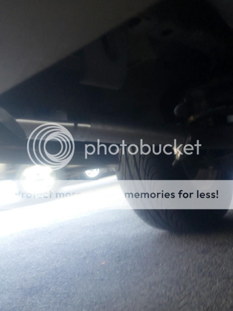

Weekend Project Done! Muffler Delete 97 Bird
Spent a few hours today and about 20$ at PepBoys (I know I know) on a muffler delete. I'd say it turned out well considering my lack of tools (I've only been in NJ for a month) and the time in it. Took two hours total.
Tools used:
Hack Saw - for obvious reasons
Pry Bar - to pry the rubber hangers off o
14mm socket for the exhaust clamps
Hammer - to beat the tips down onto the pipe
I bought 24" of 2.25" OD pipe and two cheap tips (hence why I didn't mind beating on them with a hammer), and the new tail pipes tuck up nicely where the original muffler tips used to exit. They aren't visible unless you look under the car by design because I really don't want the local law seeing it.
I also want to point out the difference in sound with the pipes/tips and without. What a night and day difference the extra pipe on each side makes!!! And here's some crappy iphone pics just because I can :D - I will provide a sound clip if its desired but I think we all know what a muffler deleted 4.6 sounds like lol
