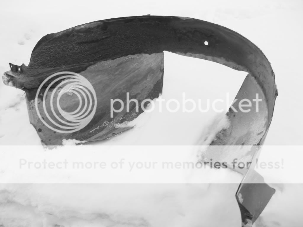

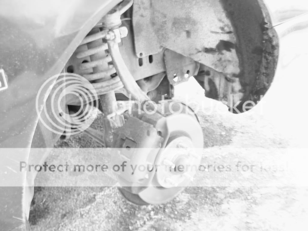

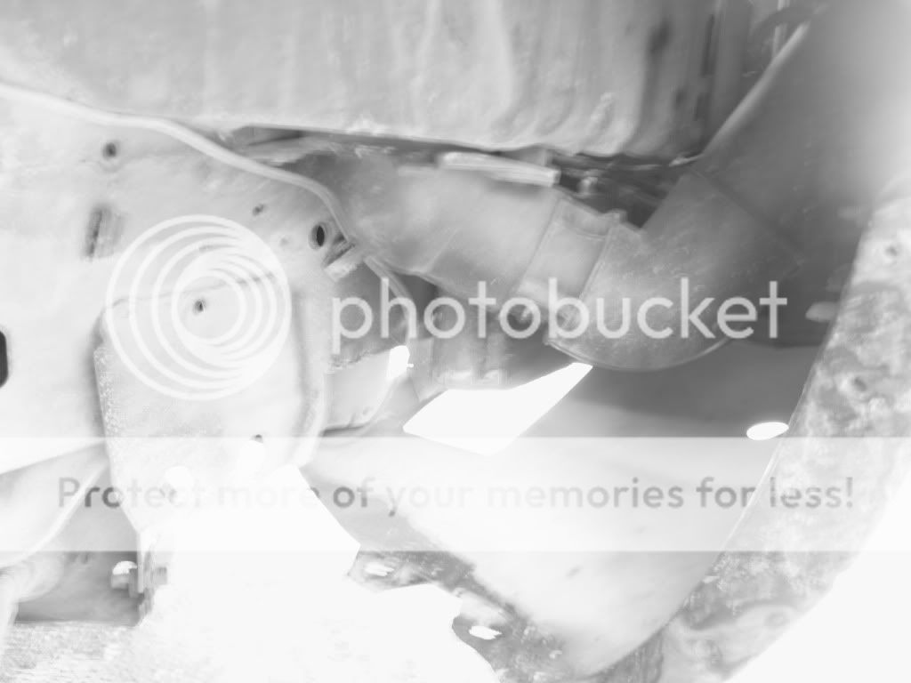

<a href="http://s920.photobucket.com/albums/ad48/Dwan_album/Coug/?action=view&current=IMG_4314.jpg" target="_blank"><img src="http://i920.photobucket.com/albums/ad48/Dwan_album/Coug/IMG_4314.jpg" border="0" alt="Photobucket"></a>
Disconnect MAF and pull off air box and filter.
Remove tire and fenderwell screws and clips.
That tube is your air silencer
Start undoing the bolts and remove the Silencer, Put it all back together PROPERLY and voila!

Those pictures will help for the weekly question of 'how do i remove it'. It is very possible and easy to remove the silencer without pulling the wheel and splash shield, but those pictures will help some folks see where it actually is. Good job.

1. It should NOT look like that when your done the fender liner needs to be re-installed to prevent water and other road debris from entering your airbox.
2. The air silencer on the 5.0 is different. You will need new bolts to re-attach the airbox as the bolts are part of the silencer. It looks like this

for the 89-93s i usually just cut the wheel hard right crawl under the front
bumper cover and pull her out with force, no need to unbolt it, the bolts will
stay in place and thus you don't need to replace them.

my supercoupes have the exact same silencer that beamerboy posted a pic of i didn't remove nothing, just reached under there and ripper her out with some brute force, only needed to unscrew the inner fender so i can pull her the rest of the way out

This is correct. I busted my rusted bolts off. The bolts are held on to the air silencer with rubber so brute force will get it out.
