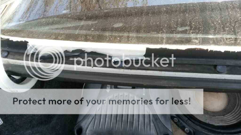

Well I finally decided to refinish my Back Glass Moulding--thinking I can't make it look worse.

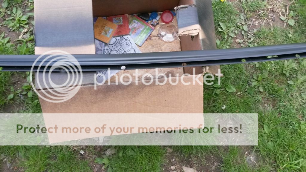

Started with :

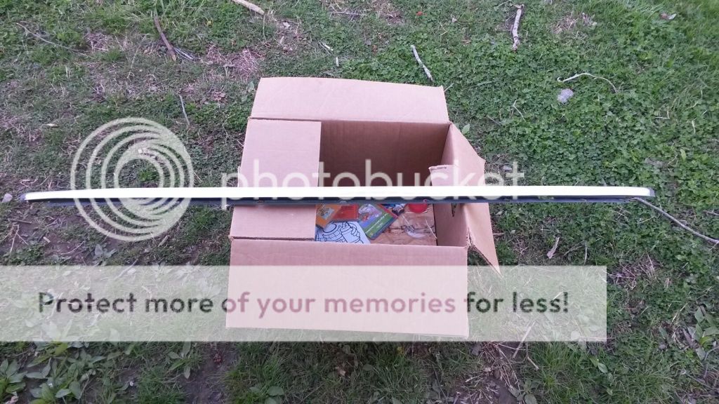

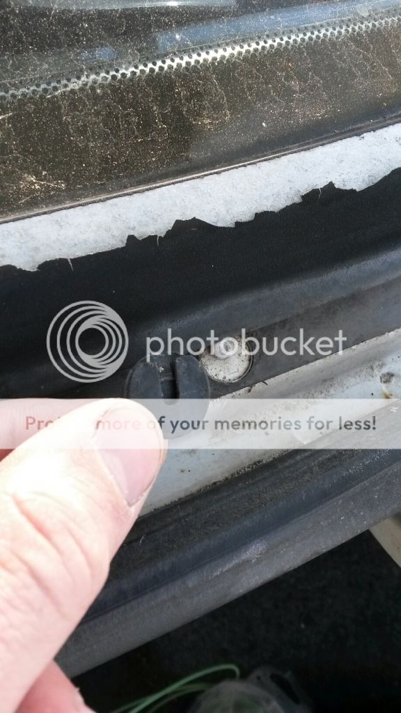

These are the Clips that hold the Moulding on they just slide on and off:

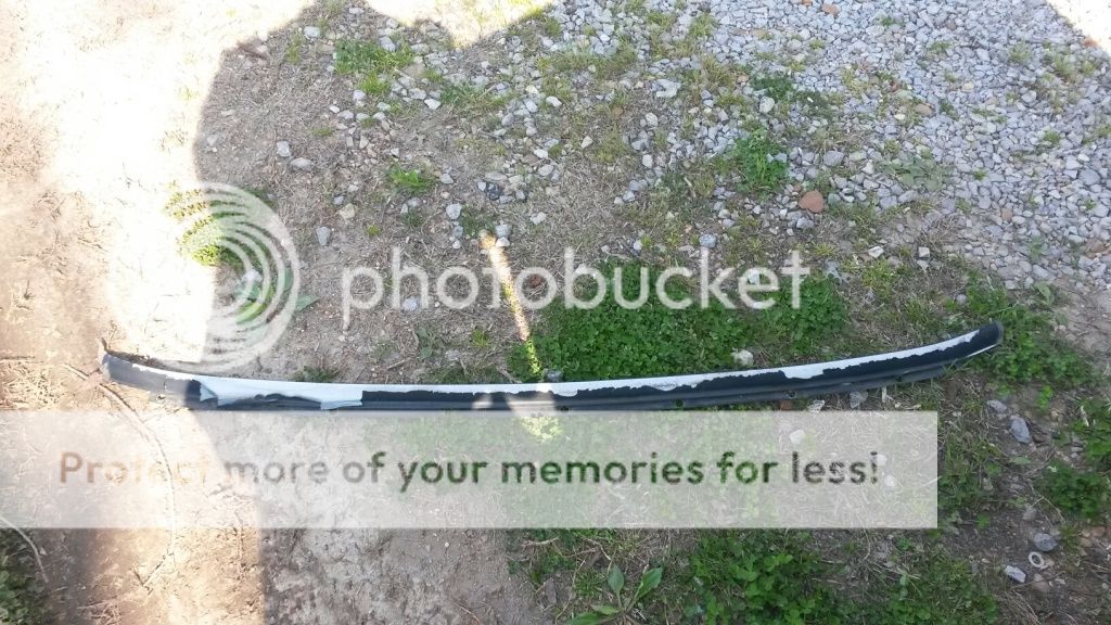

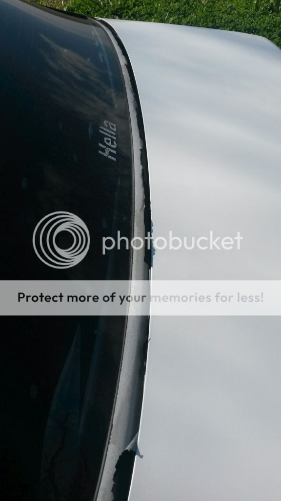

For stripping I use a Putty knife to remove the flacks still attached left with :

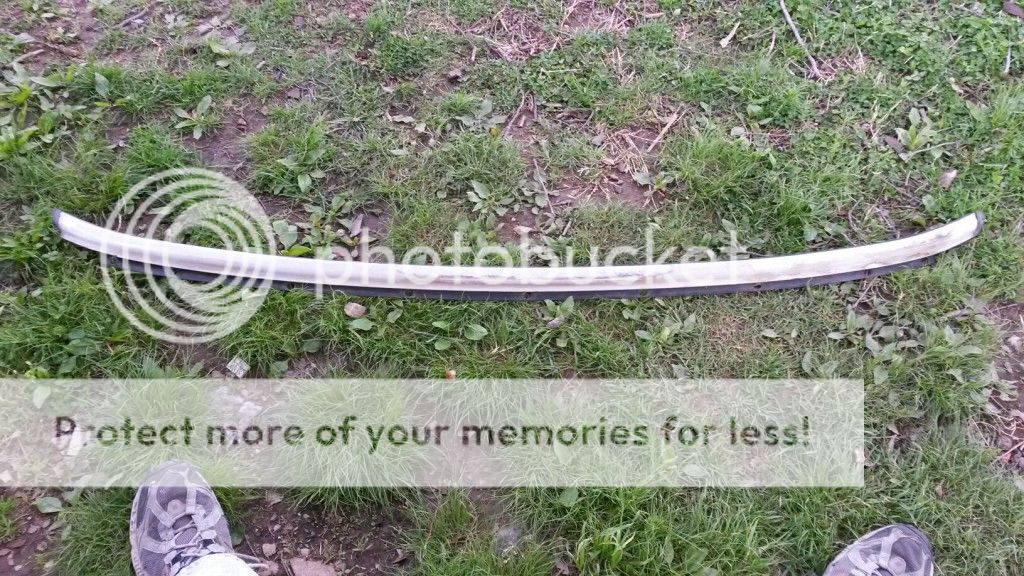

Then sanded with 80, 120, 200 and then Stoch Brite:
Be careful while sanding as the piece is aluminum so be aware of your pressure.

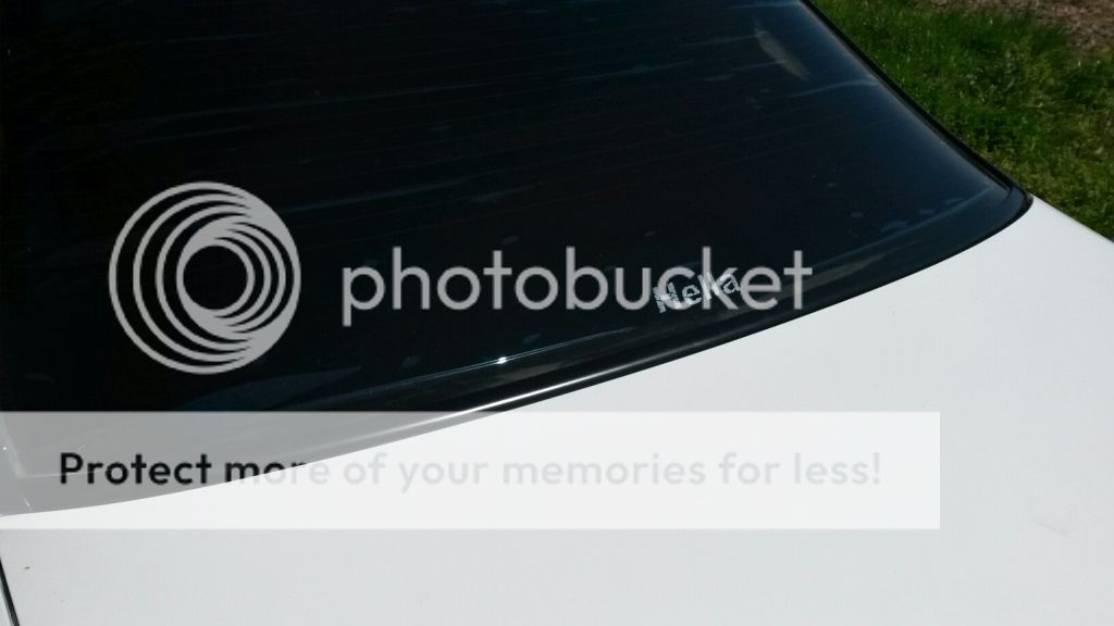

I did several coats 3+ ending up with :
And reinstalled:
