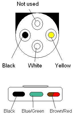

Here is the wiring info I got from ChadG
ChadG said:
-Harness Wiring:
Black (Car) to Black (Rad)
Blue (Car) to Red/Orange (Rad)
Black/Red (Car) to Red/Blue (Rad)
some of the newer fans apparently aren't using the same wiring scheme
they have black, white, and yellow on the fan
here are the connectors:
can anyone post what the other ones are lookin like on the fan? pics are drawn as if you are lookin at the plug contacts
if i can get a closeup of the plug on the cobra/stang fan, i'd be set
