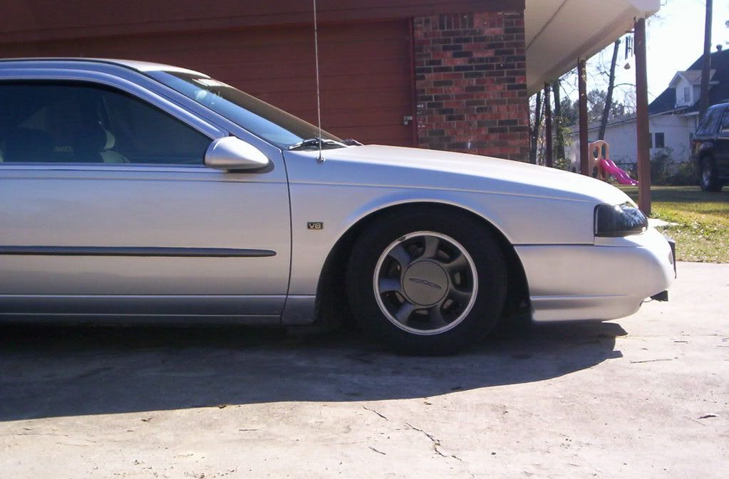

Guys, me and my girl, dropped the front of the bird tues. the springs i orderd didn't fit. so we decided to cut the original springs( 3 coils) and reinstalled them. which lowered it about 2 1/2". but my ? is what would be the best way to remove the rear springs. i have a pics tell me what ya think? :confused:

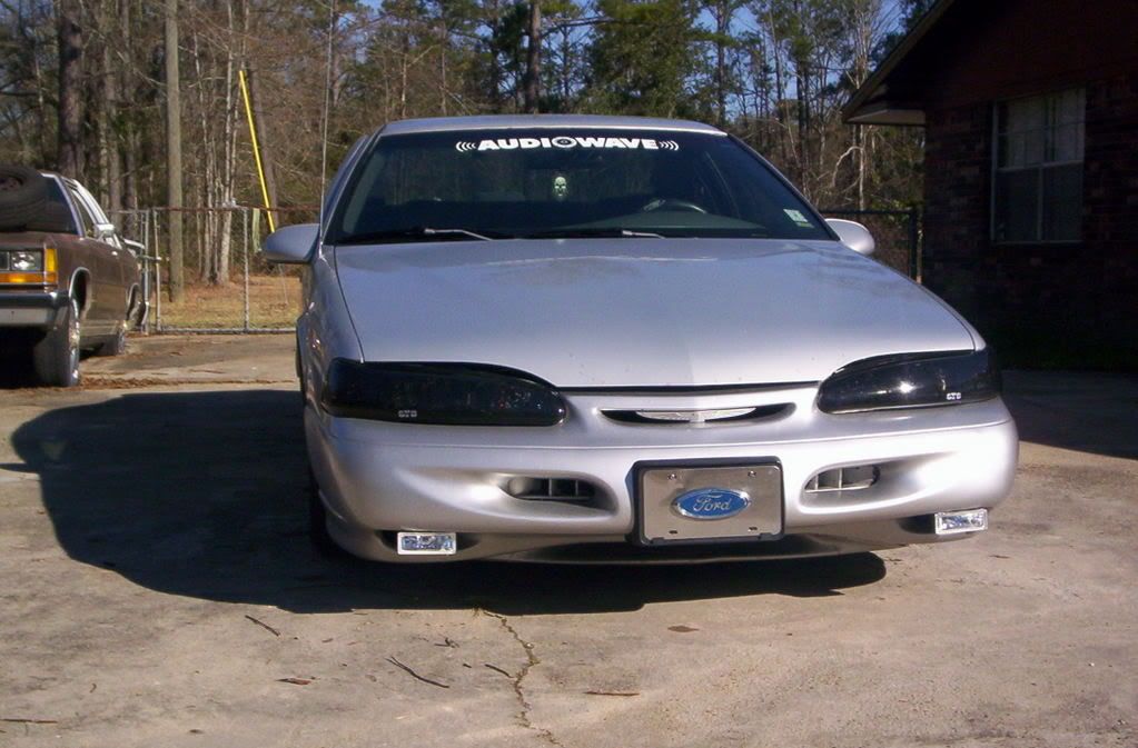

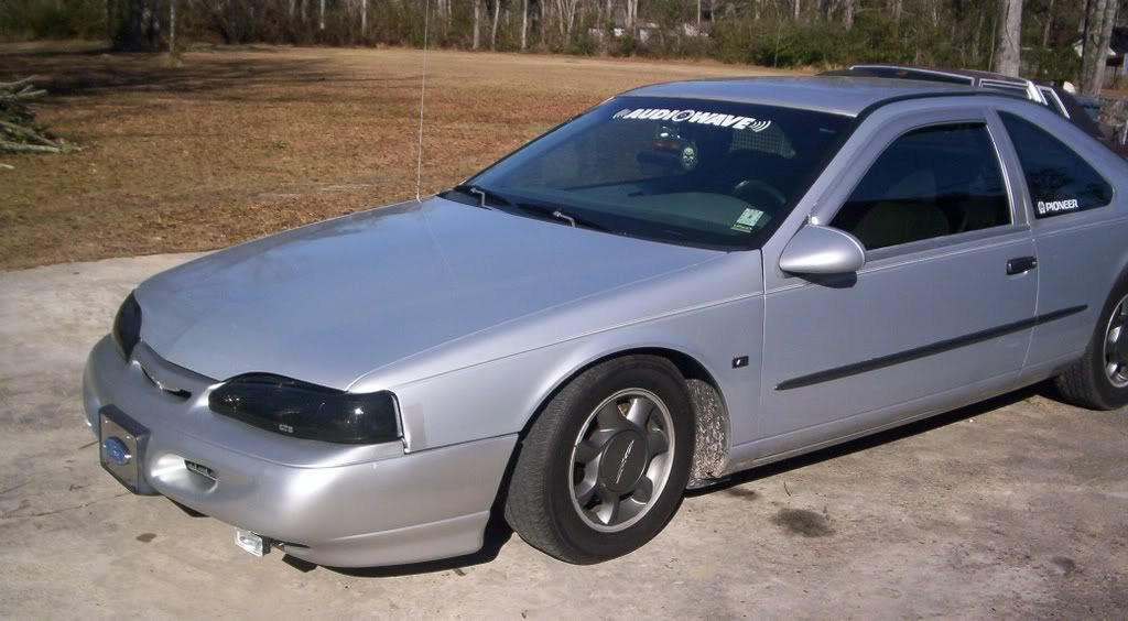

finished product to goin old school
hey thnks for all the help guys greatly appreciate it. the back was so much easier than the front. here's the finish product.
