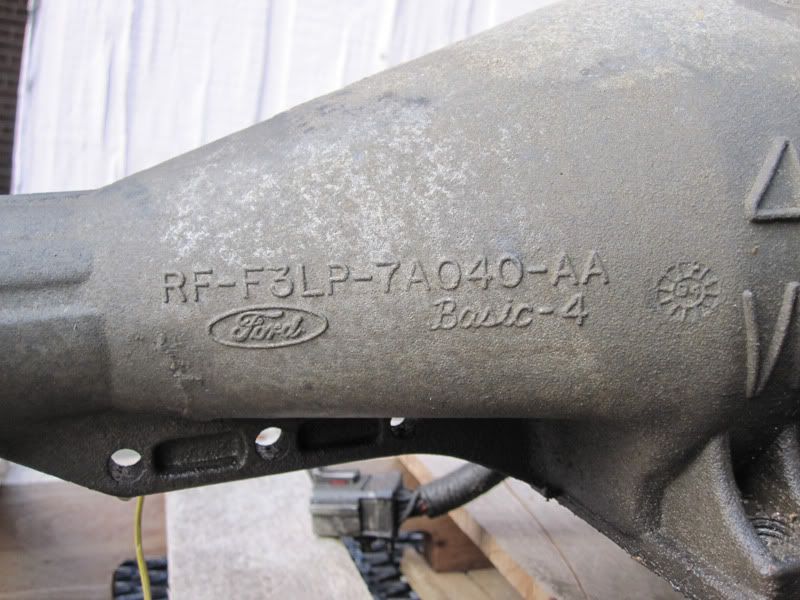

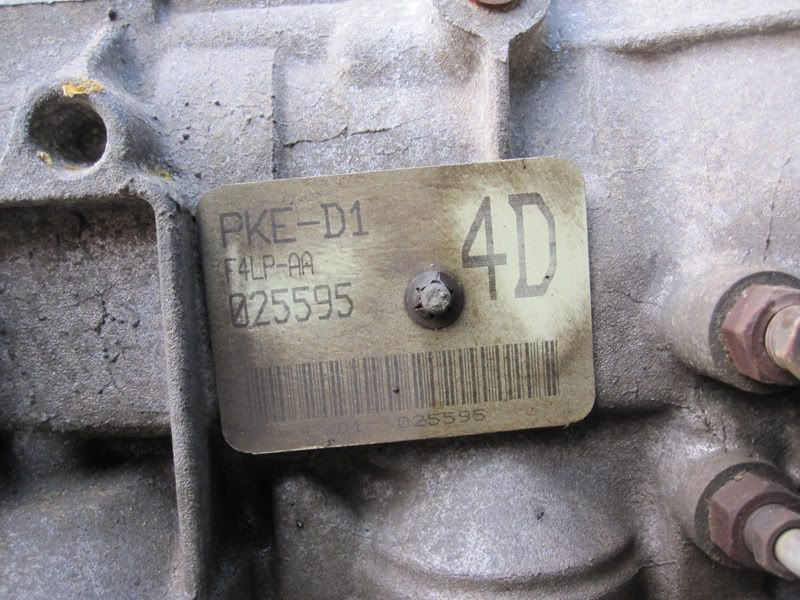

Ok I haven't had much luck from the mustang forums on whether or not this transmission will work. I figured if anyone would know it would be you guys. Anyway, I have a '96 Mustang GT with the automatic 4R70W. It slips pretty bad so I searched around on the net and found a guy with a 4R70W from a '93 Lincoln Mark VIII. He says it will work but I'm having trouble confirming this? I don't want to go through the trouble of installing new seals and putting it in the car if it's not going to do me any good. Here are pictures of it and the model numbers. Thanks for any help guys.
On the Tag:
PKE-D1
F4LP-AA
025595

Body of Transmission:
RF-F4AP-7006-AC
Tailshaft:
RF-F3LP-7A040-AA
Basic-4

If it really is from a Mark, then yes it will fit and it will work if you swap out the TCC solenoid. I guess a quick way to make sure it has the modular bellhousing is to see if it has 3 starter bolts. IIRC, the 5.0/3.8 bellhousing used 2 starter mounting bolts. Hope this helps!
2,977 Posts
Yeah, it will work if it's from a MK, but that is a serious step backwards for your car. Anything prior to 96 was so much of a pile of junk internally that they aren't worth their weight in scrap prices. I can't use them as cores because I have to throw most everything away. Starting with the case.
I wouldn't do it, but thats just the advice of someone who specializes in these transmissions ;)

I think that came from a 94 Mark VIII. The Mark VIII trannys are better than a stock 'Bird tranny because the roller clutch has more rollers. However, everyone is correct in telling you a newer tranny is even better than that because of the mechanical diode instead of the roller clutch.
Here's a list of tranny numbers I posted awhile back:
http://forums.tccoa.com/showpost.php?p=1332185&postcount=13
