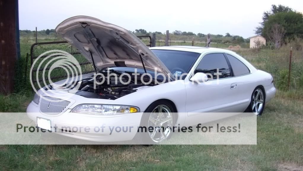

Wow that is damn nice....What does it run? HP/TQ?

Here's some of the mods:
KB 2.2L twin screw with bypass valve
42lb injectors
90mm Lightning MAF meter
255 pump
CAI
X-pipe
Borla custom made mandrel bent cat back
3.73 FRPP gears
Cobra Trak Loc with 4 clutches per side
IRS brace
K-member brace
Firewall brace
Addco 1.25" sway bars
Poly links
AHAM8 custom suspension height/spring rate controller in center console
Custom SCT tune
PLX multi gauge with wideband A/F
First made (the prototype wheels) Saleen Speedstar wheels with Yokohama S-Drive tires
Rolled fenders
Cobra brakes with slotted rotors and EBC Red Stuff pads
Trans cooler
It's only running 6lbs of boost right now with the rwhp in the mid 300's, with the stock crank pully back on it it pushes around 17lbs with a little bit more rwhp :)

:beek: Wasn't expecting to see that under the hood. Gen 2 marks have a lot of hood clearance don't they.
Not as much as you think. IIRC the hood bracing is removed and the engine cradle is shimmed.

Don't believe the subframe is shimmed, but I could be wrong.
