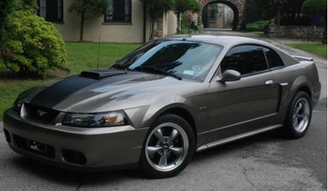

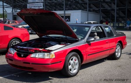

Hey guys correct me if I'm wrong but aren't all 89-97 Tbird/Cougar front fenders the same other than the 96-97 beltline molding? I'm planning to take my'96 down to the metal and respray it next year and since I'm removing the beltline molding I've been toying with the idea of going with a '94-'95 nose and front/rear bumper and hood with a '92 grill and GM headlights. I'm keeping the two tone and the red but insted of the current grey going with '99-'04 Mineral Grey (TK).

Hey thanks , I thought they were I wasn't sure about the cut-ins for the coner lights. Yeah I meant to say body molding a.k.a the ugly round crap that makes my car look fat. :tongue:
