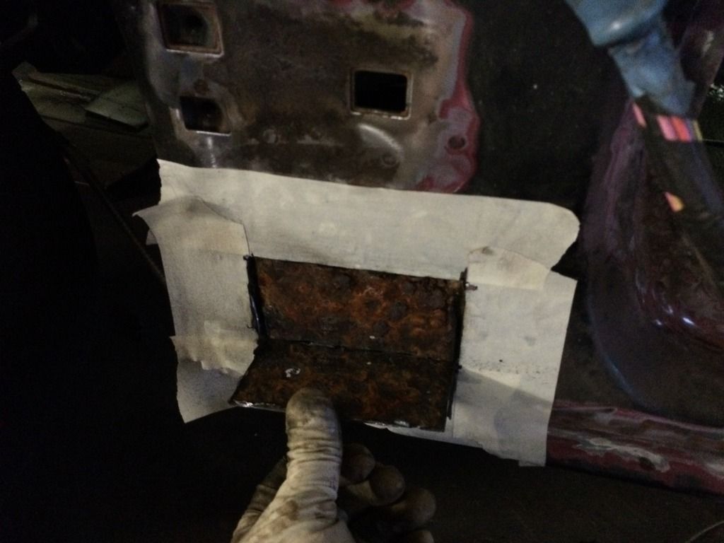

Clearly not good! The stupid foam back there had absorbed moisture and rusted out the hinge pillar from the inside. All the rusty old metal had to go!
Now this left me with a problem. I had found the last new aprin assembly in the country, but try as I might, I could not track down a new hinge pillar, and obviously one off another car would first off likely get destroyed removing it, but also probably wouldn't be in any better shape, and fabricating that complex shape would be very difficult. As I looked around the shop pondering what to do, I saw my answer!

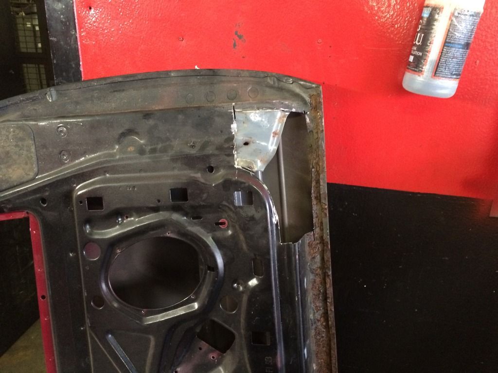

The old door from the car provides again! Since the shape of the hinge pillar in that area is designed to contour around the door when it closes, the bottom front of the door has the exact same shape.
It wouldn't cover the whole area I had to cut out though because beyond that point it gets into the area of the door under the door panel, so I cut another piece out of the skin to make the rest of the patch.

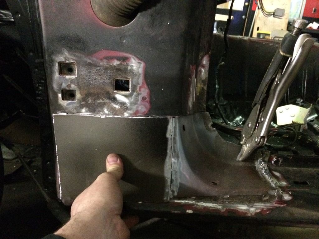

And the 2 pieces tacked together and mocked up in place.
At this point I stopped. My welding is adequate for re-attaching something that broke, or doing exhaust work, but for something that will need to be ground flat and where warping the metal is a concern, I don't trust myself to do a good enough job. Just this past weekend, my friend Chris, who was the one that referred Joe to me (Joe is the guy who did great work then disappeared), came over and assessed everything, ground down my not-so-pretty weld on the patch panel, and sprayed what he could see behind there with rust converter and weld-through primer. Within the next couple weeks, he will come finish up the hinge pillar repair, and then I can get a dashboard back in the car to make it at least steerable again. At that point, in my spare time I can re-do the rear suspension, spray bedliner on the whole undercarriage, get the transmission, wiring, and most of the interior re-installed, and take care of the fuel system and some other minor issues, and then that will only leave final body work and paint. Obviously at this point, the goal of being able to drive it this summer is not happening, but I'll keep plugging along, and hope to have the car done by the time next summer rolls around.

Making the patch panel with the piece from the door is genius. I will definitely be remembering that trick. Very sweet.
