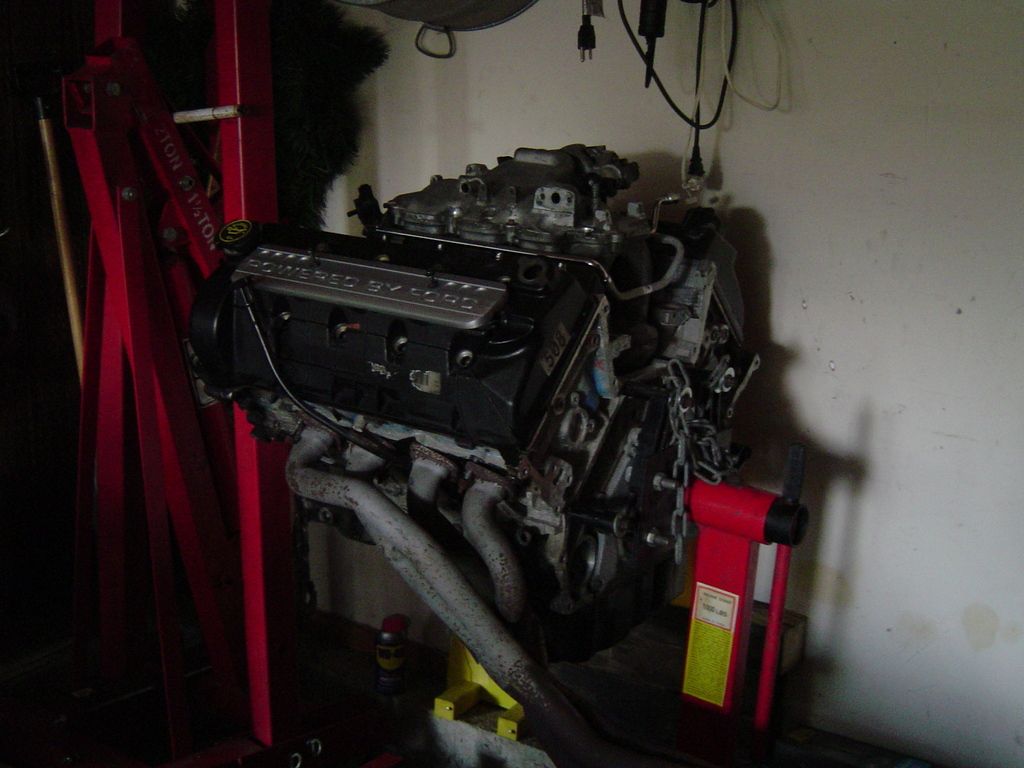

Got some done so far. Got all the "buyable" parts lined up, and trying to find a custom fabricator at the moment.
Got the exhaust off, no trouble at all. Loudest that 4.6 has ever been.
It ran for the last time today, its time to disassemble all of it. battery, exhaust, fluids, all out. Taking the top part of the motor out tomorrow to get ready to get rid of all of it. Only had 2 interested motor buyers, but one dropped off the face of the earth, and the other hasn't gotten back to me today.
If in the next week or so, nothing happens, I'm just gonna part the motor out, and sell the trans individually.
Its coming together pretty nicely.
Hardest points are already known. oil pan clearance, header clearance, wiring and the tiny bit of fabbing I have to have done.
Coming together nicely.
